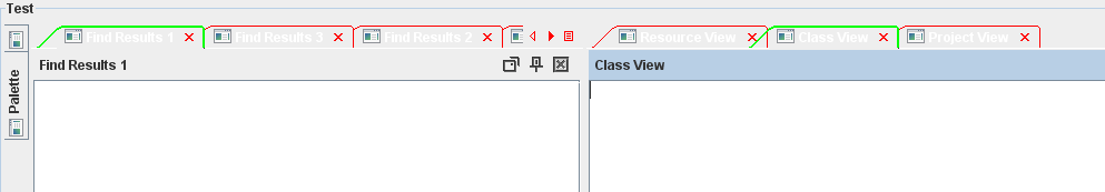

Jide Tabbed Pane "Tab Header Color"
Postby rathinamsm » Tue Mar 20, 2012 9:29 pm
Hi team,
1. As I mentioned in the First Post, if I set The TabbedPane setBackgroundColorAt(); and Application Backgroud as Same, The tab header border is hard to visible.
Please help to achive this tab header border. (Please Refer Picture Jide Post_1.PNG, Jide Post_2.PNG).
2. The Third Jide_post_3 picture shows, that the Yellow Colored box, (setTabResizeMode() - NONE/FIX).in TabbedPane. Is Not Displayed. If we Extended the Dockingmanager and FrameContainer as you suggested.
We applied the setTabResizeMode in TabbedPaneCustomizer().
_panel.getDockingManager().setTabbedPaneCustomizer(new DockingManager.TabbedPaneCustomizer() {
public void customize(JideTabbedPane arg0) {
arg0.setTabPlacement(SwingConstants.TOP);
arg0.setUseDefaultShowCloseButtonOnTab(true);
arg0.setShowCloseButtonOnTab(true);
arg0.setTabResizeMode(JideTabbedPane.RESIZE_MODE_NONE);
help me to show setTab ResizeMode ? and Tab Header Border??..
Jide Post_3.PNG (2.68 KiB) Viewed 181365 times
Jide Post_2.PNG (1.04 KiB) Viewed 181365 times
Jide Post_1.PNG (807 Bytes) Viewed 181365 times

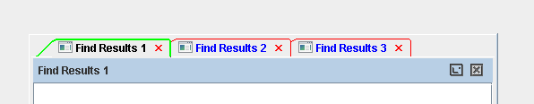

Postby rathinamsm » Tue Mar 27, 2012 5:04 am
Hi Team,
I worked based on your idea for highlighting the selected and unselected tab with border.
We successfully set the Selected and Unselected border color, tab Foreground color also sets successfully. But we Unable to set the "tab header Background Color".
Please check the overridden method. Is the approach is correct in paintBackground() for setting the foreground and background color.
Please see the attached Screen Shot_1,
public void paintBackground(Graphics arg0, Component arg1) {
JideTabbedPane jideTabbedPane = (JideTabbedPane)arg1;
jideTabbedPane.setOpaque(false);
int index = jideTabbedPane.getSelectedIndex();
for (int i = 0; i < jideTabbedPane.getTabCount(); i++) {
if (i == index) {
jideTabbedPane.setForegroundAt(i, Color.BLACK);//---Displaying - refer screen shot
jideTabbedPane.setBackgroundAt(i, Color.WHITE);//---Not Displaying - refer screen shot
jideTabbedPane.setForegroundAt(i, Color.BLUE); //---Displaying - refer screen shot
jideTabbedPane.setBackgroundAt(i, Color.YELLOW); //---Not Displaying - refer screen shot
} catch (Exception e2) {
e2.printStackTrace();
super.paintBackground(arg0, arg1);
FrameContainerTest.java
(1.83 KiB) Downloaded 9906 times
Extended_TabbedpaneUI.java
(1.34 KiB) Downloaded 9562 times
rathinamsm
Posts: 40
Joined: Wed Nov 02, 2011 5:36 am
Re: Jide tabbed pane close icon Highlight
Postby JIDE Support » Tue Mar 27, 2012 10:31 am
Please invoke JideTabbedPane#setBackgroundAt()/setForegroundAt() to change the background/foreground for a specific tab.
Postby rathinamsm » Mon Apr 02, 2012 12:51 am
Hi Team,
I tried to set the background and foreground to jidetabbedpane as you specified by the setForegroundat(), and setBackgroundat(). in the following ways.
1.Setting the TabbedPane Customizer addChangeListener();
arg0.addChangeListener(new ChangeListener() {
public void stateChanged(ChangeEvent changeEvent) {
int index = arg0.getSelectedIndex();
int tabCount = arg0.getTabCount();
for (int i = 0; i < tabCount; i++) {
if (i == index) {
arg0.setForegroundAt(i,Color.BLUE);
arg0.setBackgroundAt(i,Color.GREEN);
arg0.setBackgroundAt(i,Color.RED);
2. Defining Color at Override paintBackground() Method in BasicJidetabbedpane(); which SetUi to Frame Container. as like follows.
if (i == index) {
jideTabbedPane.setForegroundAt(i,Color.WHITE);
jideTabbedPane.setBackgroundAt(i,Color.GREEN);
jideTabbedPane.setBackgroundAt(i,Color.RED);
3. Making the ChangeSkin Method, as Like Follows,
protected void changeSkin() {
resetSkin();
jideTabbedPane.revalidate();
jideTabbedPane.repaint();
validate();
repaint();
private void resetSkin() {
int tabCount = jideTabbedPane.getTabCount();
if (i == index) {
jideTabbedPane.setForegroundAt(i,Color.ORANGE);
Please see the Screen Shot_01, in that the setBackgroundAt(), color is not repainted.
Only the foreground is repainting in resetskin().
How can i able to resolve this problem?
Postby JIDE Support » Mon Apr 02, 2012 10:41 am
Please let your ExtendedJideTabbedPaneUI extends VsnetJideTabbedPaneUI.
FrameContainer_test.java
(1.83 KiB) Downloaded 7634 times
(1.13 KiB) Downloaded 8505 times
