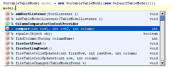

IntelliJ IDEA

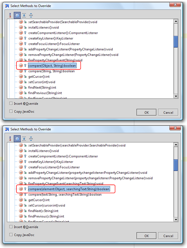

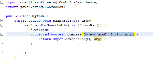

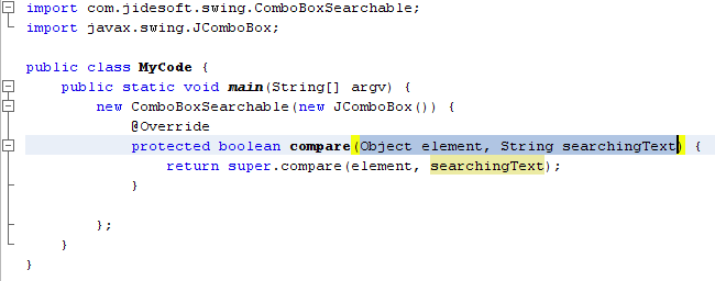

Override method dialogs
Note the second one has the parameter names and the first one only has the parameter types.

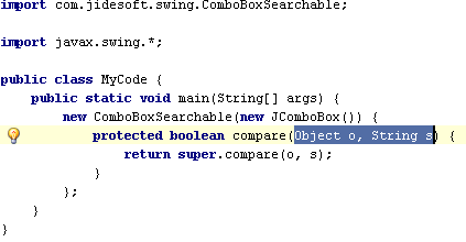

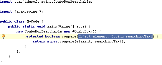

Parameter auto-completion after selecting the method to override
v.s.

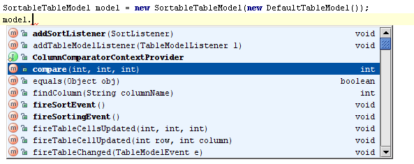

Intelli-sense on methods
v.s.
Parameter information (Ctrl-P)
v.s.

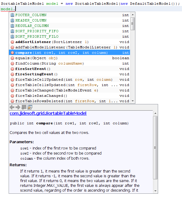

NetBeans

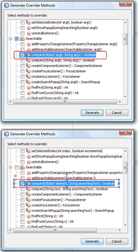

Note the second one has the extra parameter names and the first one only has the parameter names that don't make too much sense.
v.s.

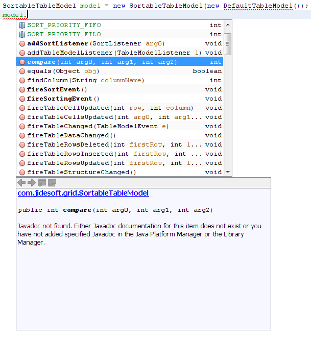

v.s.
Parameter Completion
v.s.

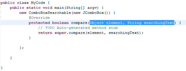

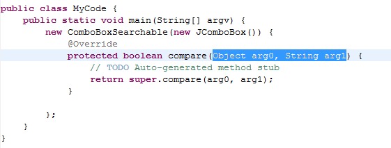

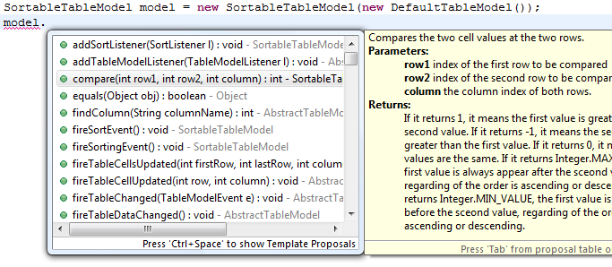

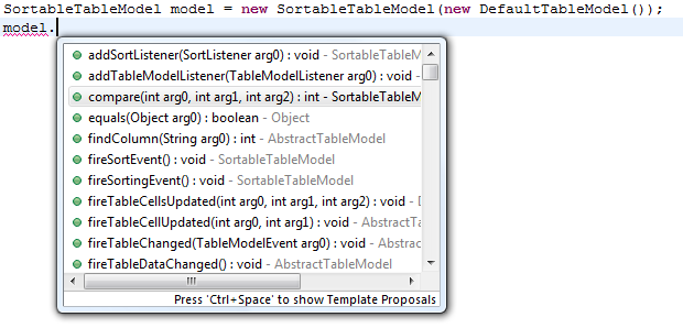

v.s.
