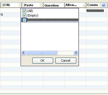

I have a column and it contains content more than a screen size. I will scroll a table and view the content in the column.
If I need to filter any value using column header, the popupmenu go beyond the monitor size and I cant able to view the OK & Cancel button in the popup menu.
Pls let me know, how to define a size for popup menu and give scrollbar option to view the content in the scrollbar. If possible let me know the code.
Note: I have attached a screenshot for your reference.

Please override AutoFilterBox#createPopupWindow() to customize the popup. Please check out JIDE AutoFilterTreeTableDemo on how you could override AutoFilterBox.

Postby JIDE Support » Sun Dec 13, 2009 10:41 pm
Sure. Here you are.

Postby Nachiyappan » Sun Dec 13, 2009 10:51 pm
Hi...
I have tried this in morning. Just I called super.customizeAutoFilterBox(). I missed to add the following two lines.
autoFilterBox.applyComponentOrientation(CustomizedAutoFilterTableHeader.this.getComponentOrientation());
CustomizedAutoFilterTableHeader.this.customizeAutoFilterBox(autoFilterBox);
Because of this, I cant able to view the OK, Cancel button. And it is looking like list.
Anyway, thank you.
One more thing, the popup menu always starts at the table co-ordinate of (0,0). But I need to show at the column header of corresponding column co-ordinate(0,0).
Please let me the solution. I will also try in the mean while..

Postby Nachiyappan » Mon Dec 14, 2009 5:20 am
1. Actually I need to override only for one column. Not for all columns.. Is there any option to override this method for a specific column.
2. While overriding this createPopupmenu() method, I can able to set size for popup. But cant able to set location.
Ref the 14Dec.JPG, the "Comment" column contains value as "jjjjjjjjjjjjjjjjjjjjjjjjjjjjjjjjjjjjj". The popup goes beyond the monitor size. So, I applied setPreferredSize as 200,200. The size of the column has been set.
But the location of popup goes somewhere away from Comment column. Please tell me some fix for this problem..

Postby JIDE Support » Mon Dec 14, 2009 8:20 am
Please use the following code instead to fulfill both specific column setting and the popup location issue.
