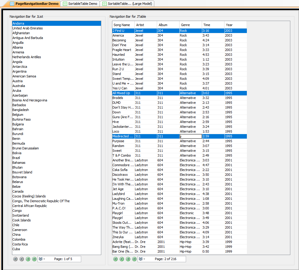

In continuation, is this a bug with selection?
When I resize the table and scroll down, I see multi selection. which should not happen.
Please refer to the screenshot.

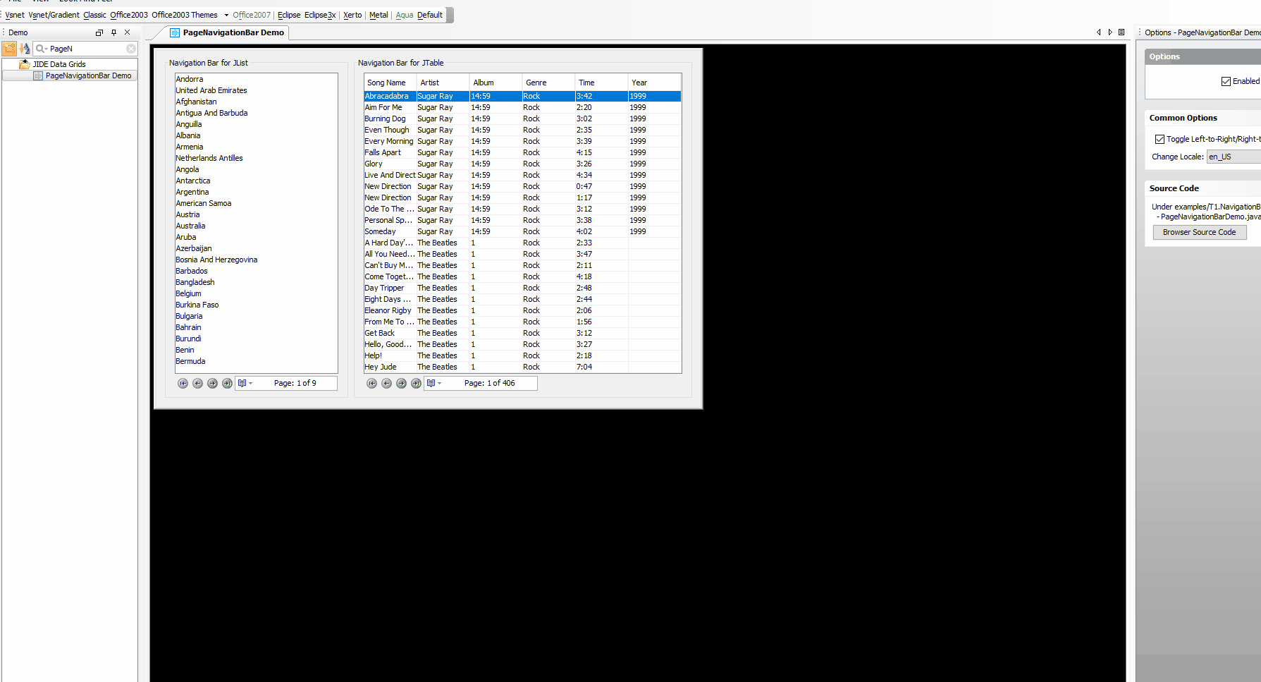

Those are 2 different problems.
The code I sent reproduces the problem when I use mouse wheel the table does not scroll. This is using both sortableTable with PageNavigationBar.
The other one, we don't need a code, you can reproduce that in there...
1. Resize the table to get smaller.
2. Scroll in the table using mouse wheel
3. Resize the table to grow bigger.
4. You can see multiple selections.

Postby aryanarvind » Thu Jul 30, 2020 10:58 am
Here is a gif demonstrating the issue.
https://gifyu.com/image/WV2o
aryanarvind
Posts: 108
Joined: Mon May 14, 2007 12:37 pm
Re: Mouse wheel scroll on SortableTable selects rows
Postby JIDE Support » Thu Jul 30, 2020 11:40 am
I am running it as a separate demo and I don't see the issue. Then I reproduce it using JideDemo and run as a nested demo. Do you see it in your real application?
Postby aryanarvind » Thu Jul 30, 2020 12:33 pm
Yes, looks like this is reproducible in a dockable.

Postby JIDE Support » Thu Jul 30, 2020 2:03 pm
I will fix it. If you want to fix it in your code for now, please override as below.
            protected void setSelectedRecordIndex(int row) {
                _sortableTable.getSelectionModel().clearSelection();
                _sortableTable.getSelectionModel().setSelectionInterval(row, row);
