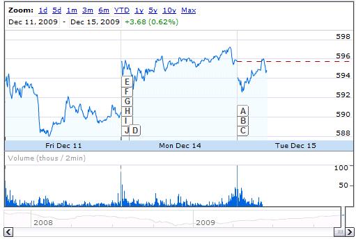

We evaluated the new JIDE Chart API provided.
Most of the features provided were useful.
Interactive Charts is one compelling feature that we require.
The UI should be similar to that of Google Finance.
We need a timeline bar where user can configure the period required to be seen in the graph.
We can assume that the X-axis is always time based and provide an abstract chart implementation.
Also let us know if it is possible to annotate the charts. Similar to the one provided in
sample screenshot (News Annotations).
Please see the attachement for a sample screenshot.
If this feature is already available let us know the chart type.

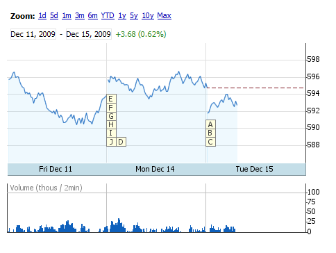

Postby charts.support » Thu Jan 28, 2010 3:53 pm
Here is the mockup generated using JIDE Charts. It uses randomly generated (independent) data for the upper and lower charts, so don't start looking for correlations between the price and the volume!
Mock up of chart screenshot

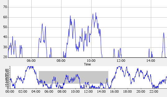

Postby charts.support » Wed May 19, 2010 3:18 pm
This is not quite the same as Google charts, but has a similar effect and is a user-interface pattern that is used elsewhere. The lower chart is an overview of the whole of the chart data and the upper chart with the bigger screen area allows you to zoom in to see the detail. When you zoom in, a grey area in the overview shows where you are in the 'bigger picture'. In my implementation, you can pan in the upper chart area or you can drag the highlighted area in the overview and the main detail chart will respond accordingly.
Here is a screenshot:
Highlighted Area in an Overview Chart
Would this approach work?
BTW, if you only want to zoom the time range and not the y axis, then this could be done with a small modification, and it should not be too difficult to make it possible to resize the grey rectangle instead of just moving it. At this point you would be pretty close to the Google charts approach, I think.
TimeIntervalSelectorPanel.java
(5.6 KiB) Downloaded 26462 times
IntervalSelectorTrial.java
(3.34 KiB) Downloaded 26063 times

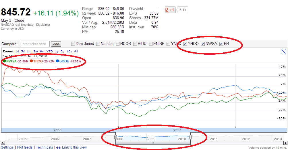

Postby infn » Mon May 06, 2013 2:32 am
Hello Jide
Thanks for providing the supporting on this issue - We evaluated the solution you have provided us - but we are afraid this is not what we were looking for. We wanted a Google Finance Stock Chart kind of a functionality with the below features:
1) Zoom to specific time interval within the chart - this time interval should be selectable by means of a slide selector.
2) Support to add multiple data series' to the chart - and have them shown in a single chart. And also user should be able to select the specific data series' he wants to view.
Pls see Screenshot attached highlighting the features requested:

Postby charts.support » Tue May 07, 2013 4:04 pm
Hello again, and thank you for the comments.
In answer to your comment about multiple data series: yes you certainly can add multiple data series to a Jide Chart. See, for example, the Cambridge Temperatures Chart in the set of demos. You would create a checkbox for each series and have the associated action make the series visible/invisible depending on the selection. Actually, if you take a look at the Configurable Chart demo you can do this by selecting/deselecting the checkboxes for the lines and points of the Sine and Cosine curve. You can use the same mechanism in a finance chart. A feature of Jide Charts is that you don't have to remove the series from the chart completely - you can choose to make the series invisible and then make it visible again when needed.
We do not currently have a range selector that is just like the one in Google charts. But it would be possible to build one like it using Jide Charts. My example earlier in this thread was an attempt to demonstrate that it would be possible and is perhaps something that you could build upon. We don't currently have any plans to build such a component, but we may be able to help you if you would consider sponsoring the development.
