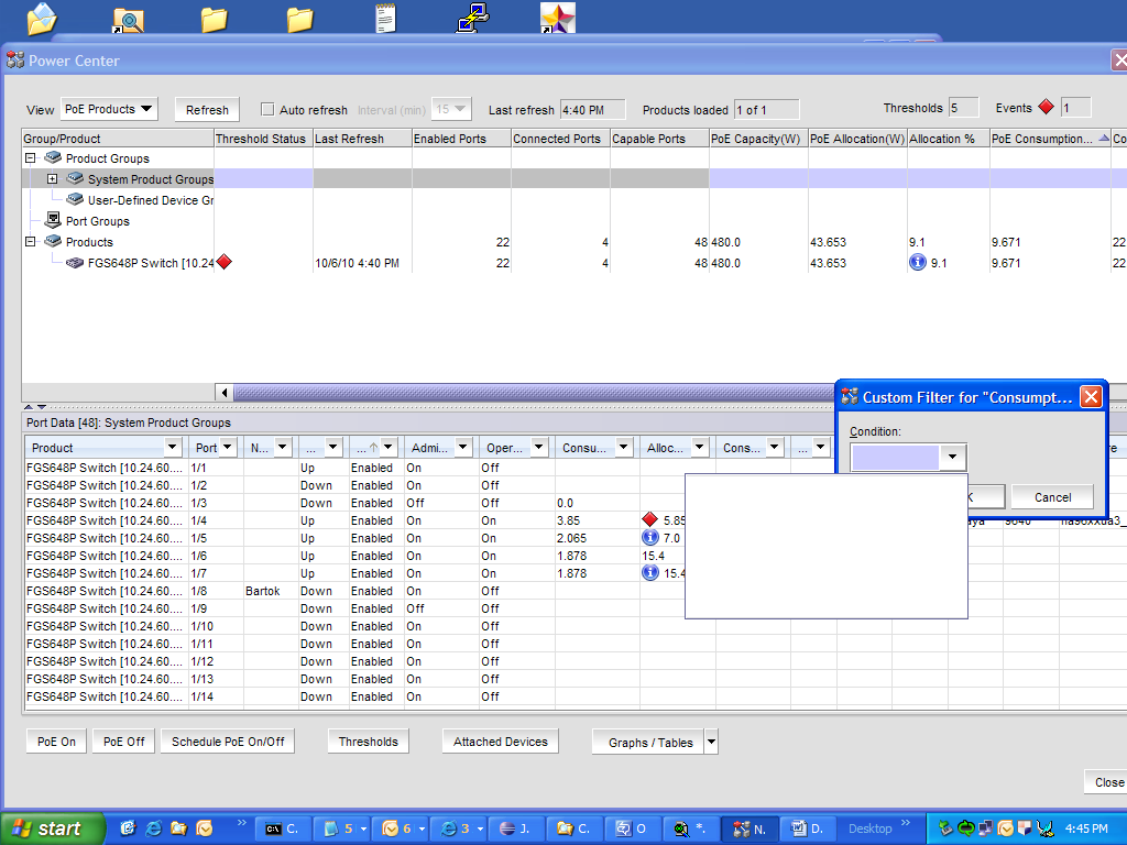

Postby brocade123 » Wed Oct 06, 2010 5:02 pm
Hi ,
My table has few columns of type Custom class which extends JLabel instead of primitive and I have custom cell renderer for them.
public class PortTableDataValues extends JLabel {
private static final long serialVersionUID = 1L;
public PortTableDataValues(){
super();
public PortTableDataValues(String label){
super(label);
public String toString(){
return this.getText();
public boolean equals(Object obj) {
if(obj instanceof PortTableDataValues){
return (this.getText().equals(((PortTableDataValues)obj).getText()));
else
public int hashCode() {
String hascodeVa=this.getText();
return hascodeVa.hashCode();
My table model returns object of type PortTableDataValues for these special column which displays text and icon .
I am pasing this table model to create FilterableTableModel-SortabletableModel to create SortableTable
Column data is fine and header list is also displaying text value but when I launch Custom Filter dialog when option "Custom" from list (it has all,custom and column values) is choseen.Dialogue is empty(see the screen shot).
I am overriding JLabel equals and ahshcode method also.
Please advice why the custom filter box is empty and does nt display (is anything,is etc)

Re: Custom Filter Demo
Postby JIDE Support » Wed Oct 06, 2010 10:30 pm
Please invoke FilterFactoryManager#registerFilterFactory() to register availabe filters for your class.
Postby Praktikant » Thu Oct 27, 2011 12:05 am
I have the same problem as brocade123. The custom filter dialog is empty. What I should do to have all the values like in the Demo?
Thank you
Postby JIDE Support » Thu Oct 27, 2011 10:29 am
Please register filter factories for the custom class. This is the code fraction to show how we register filter factory for Number.class FYI.
