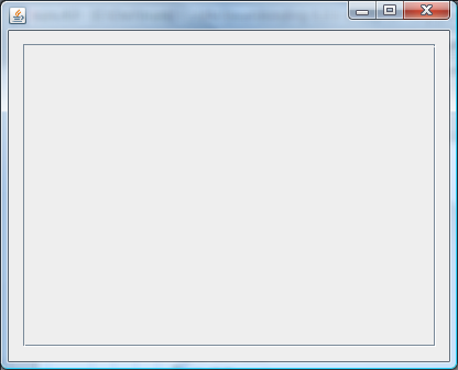

Sorry for the late response. Embarrassingly, although I could get your source code run, I cannot see any visible row even if I change the table to JTable, which blocks me to next step for selected item. Not sure what I did wrong. Attached is the modified test case FYI. Tried to run it in both Netbeans and IntelliJ and got the same empty frame.
