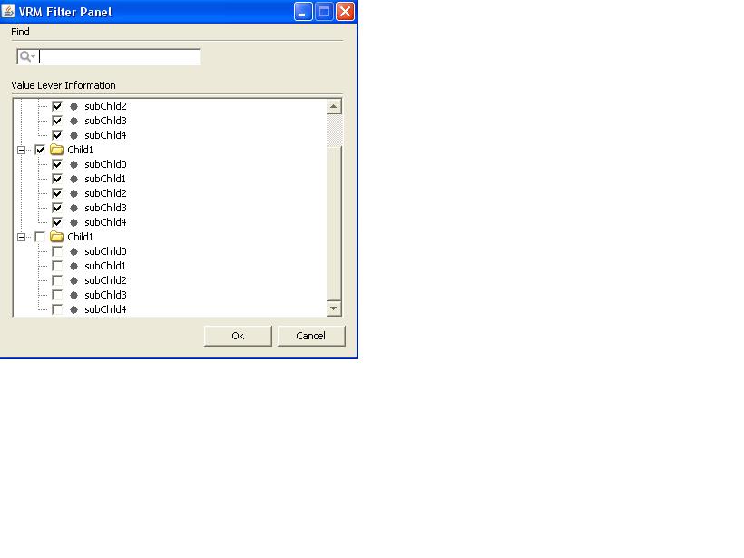

after selection

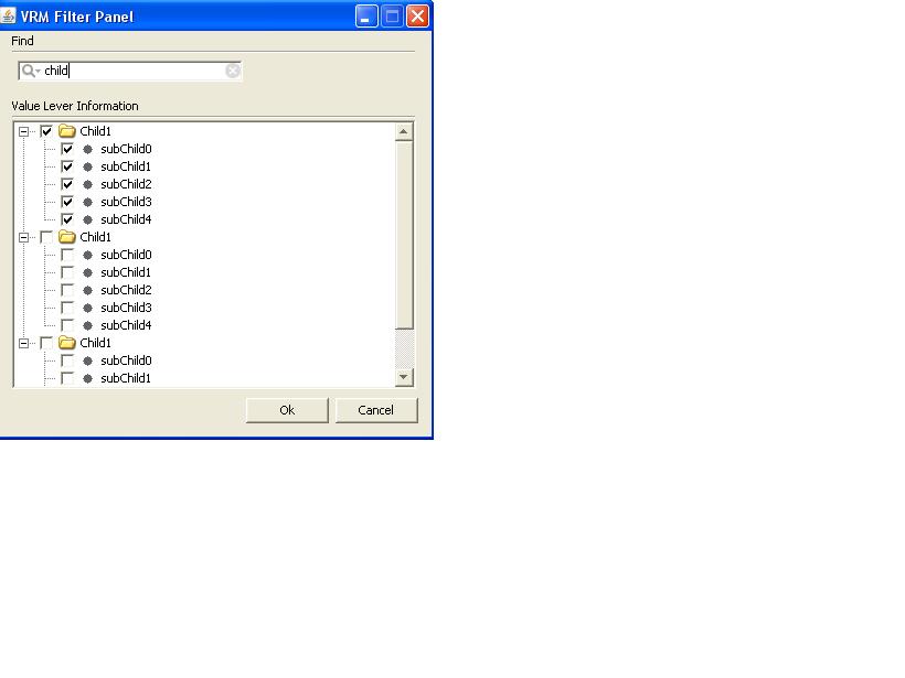

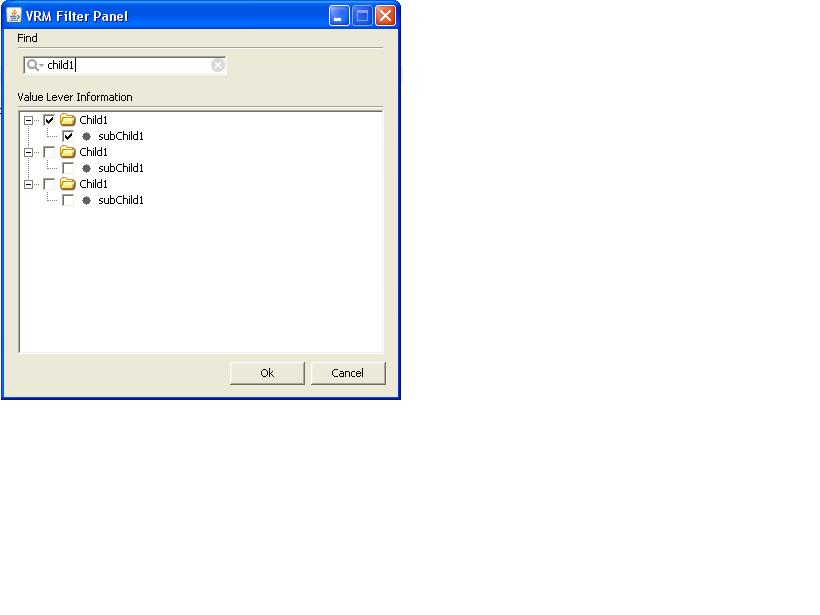

after filtering

The second question is
1.we implemented search facility for the sample dialog. if you see the second screen shot in the previous mail ,we can search the node by giving some input in search field and accordingly it is displaying the node information. but when we select the displayed node then all the siblinbs are being selected.that is shown in the first ui screen shot in the previous mail.
please help me out...

Postby RajaRajeswari_V » Wed Jun 24, 2009 12:15 pm
No. if i clicked on subchild1 then all the subchilds i.e subchild2 ,subchild3,subchild4 are getting selected.
For example ..consider the following tree
Child1
subchild1
subchild2
subchild3
if the user is searching for subchild1 ,he will give the same text in the search field . then following view will be displayed in the ui..
Child1
subchild1..
then the user selects the subchild1 then all the subchild2 ,subchild3 are getting selected.
to show this i attached the ui screens also.please help me out..

for more clarity if you see ui.jpg which was sent on earlier thread
case 1:
i am searching with child1 text in search field..
then it is showing the following information
child1
subchild1
then i selected the subchild1 ..then the child1 is also get selected which is normal tree behavior
case 2: please see the ui1.jpg
after that i changed the text to child... then the problem is coming ..previously i selected only subchild1 ...but it is showing all the subchild1 & subchild2 & subchild3 as selected..
i hope the problem is clear to you.. please help me out..

Postby jamindhar » Wed Jun 24, 2009 9:10 pm
it solved my problem. but again it is giving one more problem.
i can select all the selects all the childs by clicking their parent node. but to remove if i click on the parent node it is not changing it state.. i.e consider the follwoing tree
child1
subchild1
subchild2
subchild3
if click on child1 then all the subchilds are selecting.but if i am trying to unselect child1 it is not working ...please help me out

Re: how to insert a node to existing check box tree
Postby jamindhar » Tue Jun 30, 2009 5:47 am
Thank q for considering my request. today i downloaded the jide version and evaluted. it solved my problem but one problem is coming with this code. it is allowing me to select n-1 nodes only.not n node.
For example
Root
child1
child2
child3
are there .i am able to any of two childs . if i am trying to select all the child nodes then it is giving the following exception
Exception in thread "AWT-EventQueue-0" java.lang.NullPointerException
at com.jidesoft.tree.FilterableCheckBoxTreeSelectionModel.a(Unknown Source)
at com.jidesoft.tree.FilterableCheckBoxTreeSelectionModel.areSiblingsSelected(Unknown Source)
at com.jidesoft.swing.CheckBoxTreeSelectionModel.addSelectionPaths(Unknown Source)
at com.jidesoft.tree.FilterableCheckBoxTreeSelectionModel.addSelectionPaths(Unknown Source)
at javax.swing.tree.DefaultTreeSelectionModel.addSelectionPath(DefaultTreeSelectionModel.java:303)
at com.jidesoft.swing.CheckBoxTree$Handler.toggleSelection(Unknown Source)
at com.jidesoft.swing.CheckBoxTree$Handler.mousePressed(Unknown Source)
at java.awt.AWTEventMulticaster.mousePressed(AWTEventMulticaster.java:262)
at java.awt.Component.processMouseEvent(Component.java:6131)
at javax.swing.JComponent.processMouseEvent(JComponent.java:3265)
Postby RajaRajeswari_V » Tue Jun 30, 2009 9:14 am
its working fine.but it is giving problem when i unselected the filtered item..
For example
Child1
Subchild1
Subchild2
Subchild3
step 1: select child1 it will selects all the childs...
step 2: search for subchild3
step 3: Then it will display child1>subchild1 with selected state..
step4 : then unselect selected state for subchild 1 and search for different sub child ..then all the subchilds are unselected :(
Please help me out
