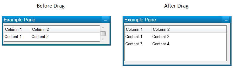

I am currently developing a List of CollapsiblePanes to display information but some of the panes contain JTables that contain many rows. I want to be able to resize every pane by dragging the base of the pane so I can display as little or as much of the JTable as I need.
Is there support available to allow the CollapsiblePane to be resized by dragging the base of the pane?
Example

Dashboard has that feature built-in. You can run CollapsiblePaneDashboardDemo.java in our demo to see it. Just drag and CollapsiblePane to the Dashboard and you will be able to resize it. You can also build a Dashboard by code without user DnD.
