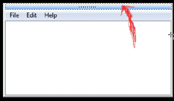

Postby ias_rd » Wed Mar 05, 2014 12:47 am
Thank you for your quick response,
I meant in the top of the popup component. As you can see in the image which i uploaded.
ias_rd
Posts: 115
Joined: Mon Nov 01, 2010 1:00 am
Re: JidePopup border and movable component customization
Postby JIDE Support » Wed Mar 05, 2014 9:36 am
That's a Gripper component. You refer to https://github.com/jidesoft/jide-oss/bl ... perUI.java source code to find out the details. The paintBackground method is the one that paints the background. You can override it.

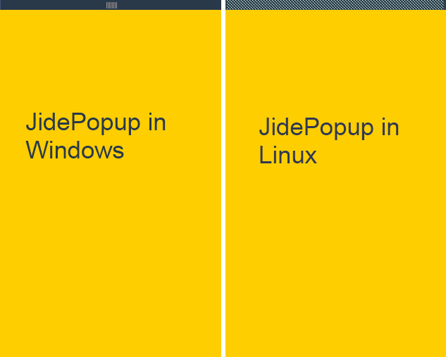

Postby ias_rd » Thu Apr 24, 2014 1:55 am
Hi there,
I have some problems about Gripper component.
Firstly gripper doesnt look at Linux the same as at Windows. I have uploaded a picture, That's showing how it looks at each os.
At linux os gripper is creating lots of dots as you can see.
Secondly I made a customGripperUI which extended with BasicGripperUI as you sad. But I havent found any method to set my custom gripper ui to gripper component in JidePopup. How can I set my customGripperUI ?
gripper
ias_rd
Posts: 115
Postby JIDE Support » Thu Apr 24, 2014 8:15 am
It looks like the default gripper style for Metal L&F.
You don't need a UI for it. Just create a com.jidesoft.plaf.basic.Painter and set it using UIDefault "Gripper.painter".
